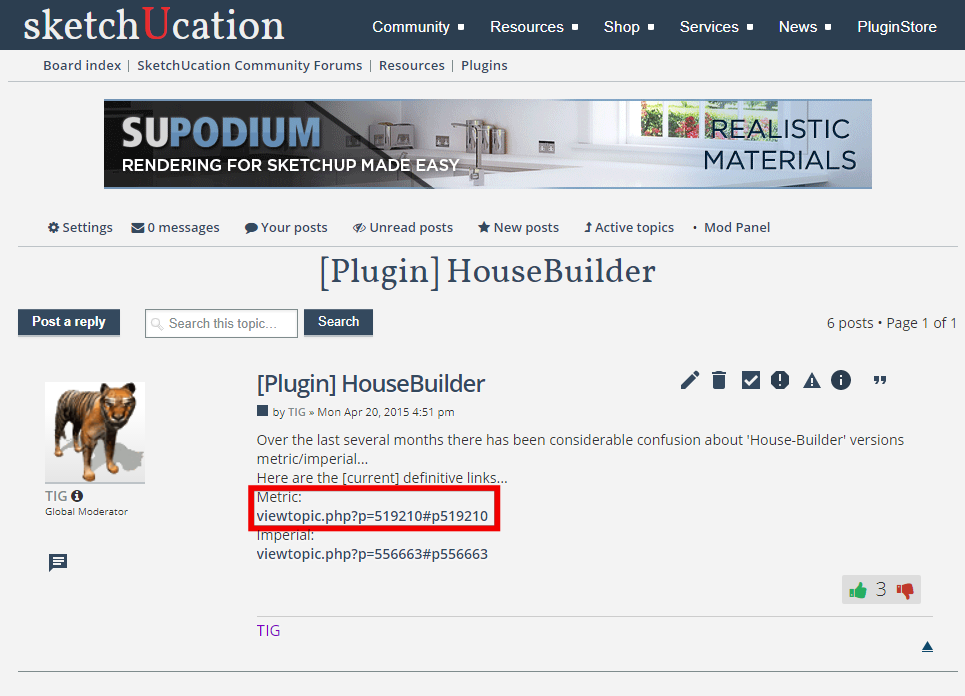

Yes. The one there has not been updated and probably never will be. Instead, get the updated one of your choice from Sketchucation. There’s both metric and imperial versions.
Before you try installing the updated version, I would suggest you clean out the Plugins folder or anything from the version you tried to install.

Why do you say that. The link is not a dead end. The link I provided goes to a post on the Sketchucation in which TIG provides the links for both the metric and imperial versions of Housebuilder. The metric one is highlighted.
If you aren’t a member of Sketchucation, sign up. It doesn’t cost anything.
It’s no different to install than other extensions that are packaged as RBZ files.
After you download it to your computer, use Install Extension from the Extension Manager to install it. No big deal.

And my trouble with getting TIG’s metric file was that I was logged in. I
had to logout log back in and backtrack to the link, it just worked after
that. Perhaps was a matter of refreshing.
