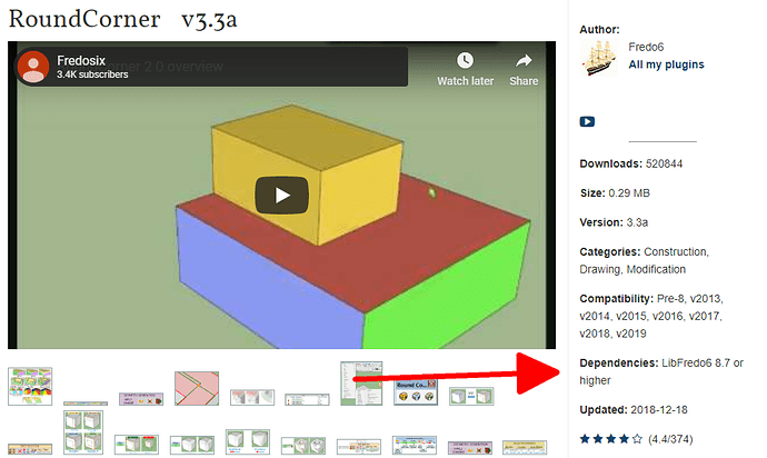

I had this issue as well. Although I did a ‘Repair’ install of sketchup as suggested, what I finally caught in the details of one of the youtube videos from thesketchupessentials, was to download the library as well - (libfredo6_v9.1 was the latest for me). I’m good now!
FWIW, Fredo explicitly calls out the dependency on LibFredo6 in numerous places and most of his extensions require the installation of the LibFredo6 support files.
