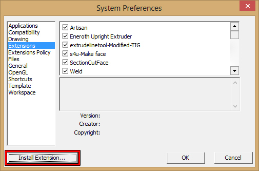

I found a downloaded a plug-in based on advice I got in a post here. The plug in is Fredo’s Tools. I installed the Fredo Lib mgmt tool successfully but I cannot get the tools to install. Is there a way to install it in SU instead of through the sketchUcation interface?
Hello! If you’ve downloaded an RBZ file then you can easily install it. Go into the Extension tab in your Preferences and click on Install Extension, locate the RBZ and you’re done. If you’ve downloaded an RB file, you’ll have to manually install it by placing it into the Plugins folder of SketchUp.
It took me a bit to find the Preferences menu (Window>Preferences) but after that your instructions were clear and perfect. I now have the tools installed from my downloads folder using this process.
