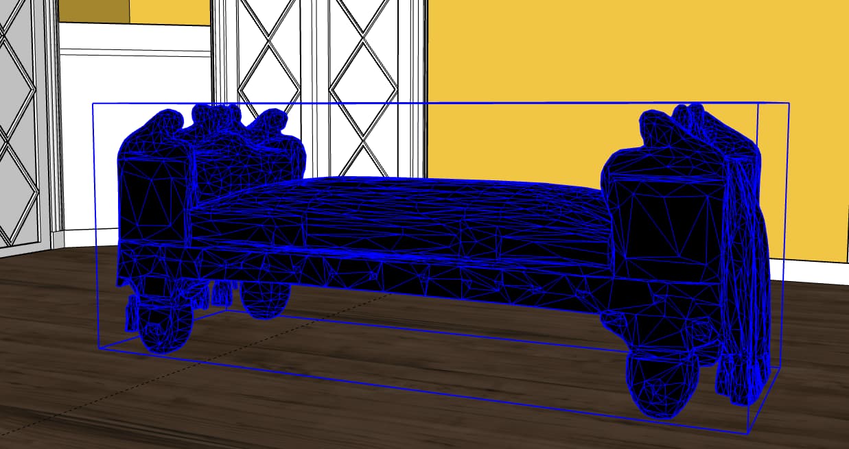

I’m using SketchUp Pro in an Edge browser (I can’t use a desktop version, nor can I use extensions). When I went to import the .dae file, in the Import Collada pop-up, I had the options ‘Validate Collada file’ and ‘Merge coplanar faces’. I set both to Yes, but after it processed my file and adding it to my room model, it only showed the settee without the textures/colours.

If you use a version of SketchUp in a web browser, and you want the imported model to also be textured, import the ZIP file, not just the DAE one.
Well I feel stupid… thank you! That has worked.
