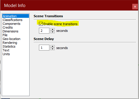

Secondly, is the model’s global Scene Transitions property enabled ?
See the Animation panel of the Model Info dialog …
Be sure also that the modelwide time settings for transitions and delay are want you wish.
(Ie, a transition of 0 is meaningless.)
Yup, those setting you displayed are the exact settings I was using and still nothing
