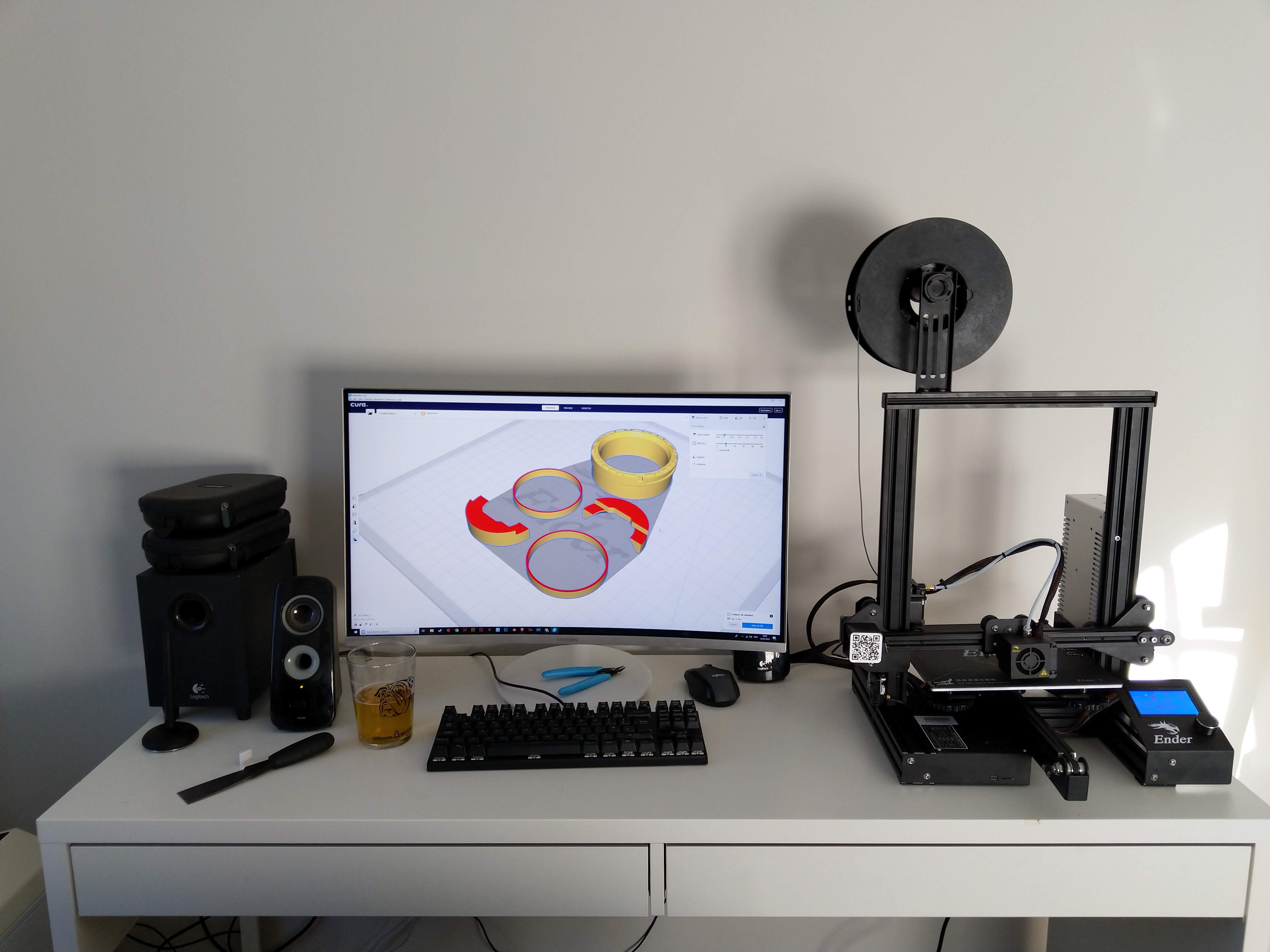

Here is an example of how easy it is from yesterday/today:
(this is my printer, just a standard Ender3 https://all3dp.com/1/creality-ender-3-3d-printer-review/ for 199USD).
  1. I make my component in SketchUp, it can be many groups just as long as you group them all together before you export. This example is about 18 groups all grouped into one. Ive had a check to see if the object is a solid, I dont usually use solid inspector as my models are simple but if you get stuck it can really help you out. I then export it as .STL but other formats work too.
  2. I open the file in Cura, select my printer (Ender 3) from the list and it gives me my plate size. I place my component on the virtual plate and then choose settings such as the fill technique and support.
  3. I then hit preview and it will show me in real time every movement on each layer that will be made to I can make any adjustements. In this example it’s 711 layers, 101g of material, 33.76 meters of filament and it will take 17 hours 19 mins. I then hit save to file and it exports the data to GCODE (the printer itself does not take an actual .stl file but coordinates instead.
  4. I load the file onto the printer with a SD card and set it running.
    I put this file on yesterday and its almost finished now.
