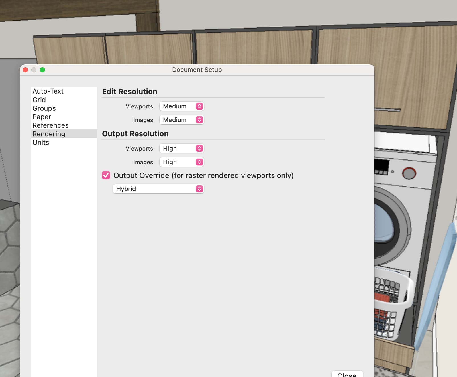

I have a question. My lines in SketchUp are not nice and straight. and neither in layout.
Since I got my new Macbook pro m2 16 inch 32 GB storage 1TB. I have already checked everything at the institution. But especially when I save Layout in PDF high quality, I have jagged lines. can anyone help me with setting this up?

Share you LayOut and SketchUp files so we can see what you have set up and compare the result on different machines.
In the SketchUp Graphics panel of the Preferences dialog, what is anti-aliasing set to?
