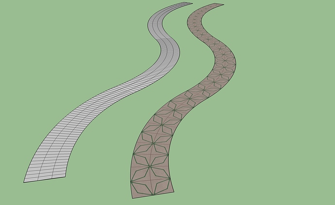

I did this with SketchUV /Tube mapping.
I first created one line, then offset it then connect both with Curviloft then apply the texture, then use the plugin.
ely862me, thank you man, it is exactly what I needed :slight_smile:
