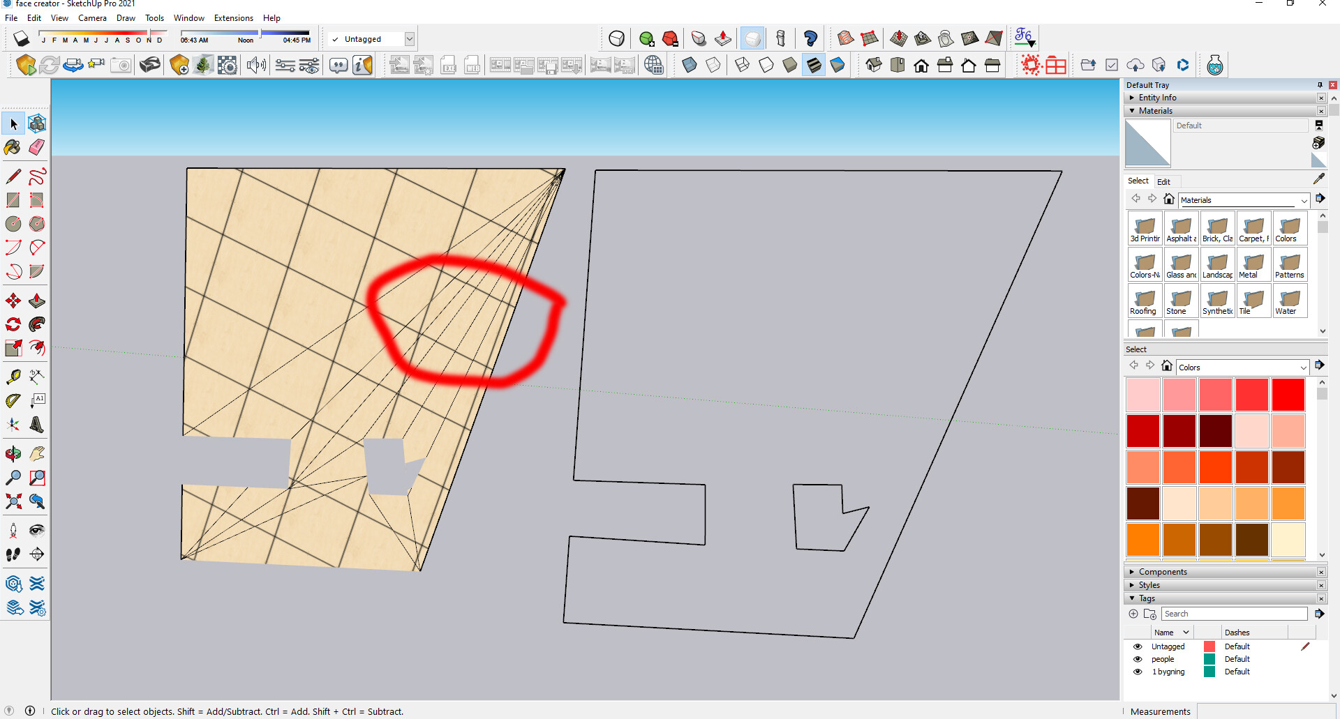

My problem is that we received a scanned DAT file, opened in Max then exported to sketchup but it comes with so many faces each shape. After isolating the “flat” shape/group of faces) I created a line around the shape and want to create faces.
Perhaps there are other ways to create faces out of lines.
As there are so many faces the textures look weird because they follow the faces shape.

Yup, right click shows the isolate but not the Face Creator. I go to menu extensions & check Face Creator but nothing happens
Face Creator isn’t supposed to show up in the Context menu. It’s only supposed to show up in the Extensions menu
Do you have closed loops of coplanar edges before choosing Face Creator?
