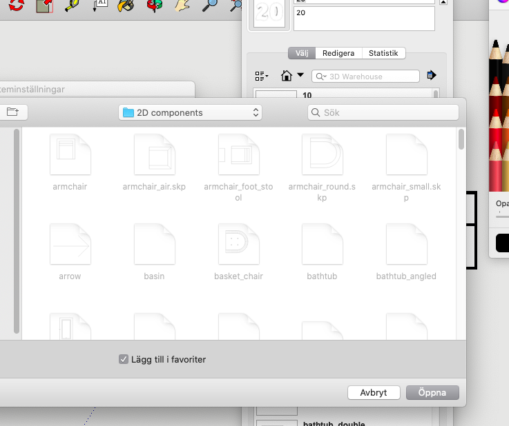

I see /Users/malinbengtsson/Library/Application Support/SketchUp 2017/SketchUp/Components there, but I don’t understand where that is… Where do I find Users for starters… :flushed:
It’s nothing there when I click on the folder icon to the right.
I can see another folder I have made though.

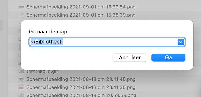

in the [menu] search for the swedisch equivqlent of ‘Go’:
type:
~/Library
hit enter
Thank you. But I can not find any SketchUp 2017 folder there.
You went into this folder:
you need to go into this folder:
~/Library/Application Support/
I tried, but I’m probably doing something wrong. I am totally confused now. Maybe I should download SketchUp again and see it that changes anything…
You are looking in the right place, for where SketchUp usually saves components. But, I think you have been saving the components into another location, and so they don’t show up in the Components panel.

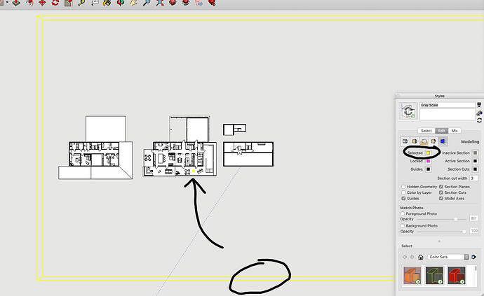

Mike was right about the replace text being missing because you are trying to convert a group to a component.

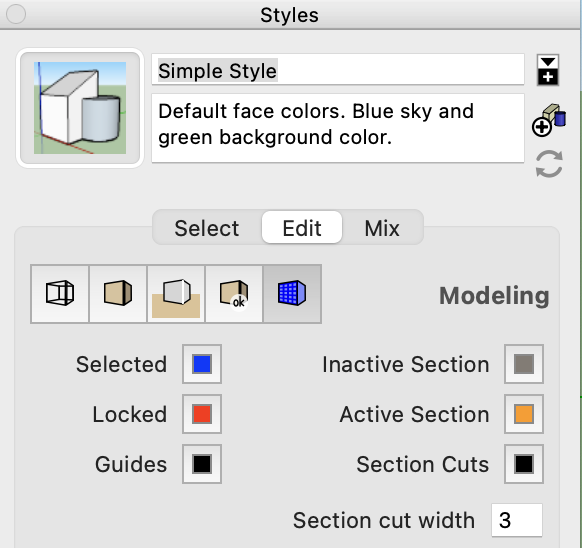

Not sure why the object had the yellow lines around it, but you could open Styles, and Edit the one you are using, to see if you have yellow set for the locked state.
Aha! You should not make a group before you make it into a component. Just component right away. I get it now! Thank you so much! :heart_eyes:
Locked for me is dark pink. Selected is yellow.

Just posting a screenshot doesn’t really help us sort out the problem.
Attach the model so we can check it.
The two most likely options are you have stray geometry within each component a long way from the main part or you have somehow set the component axes/origin a long way from the geometry.
https://3dwarehouse.sketchup.com/model/982e4f44-f963-46c3-86be-05a25ee750e1/VINTERSOL
I’m not sure where to start with your issues. Unfortunately I don’t have time to delve very far just now, but one of the major things is your model is absolutely full of hidden stray geometry. This is causing your huge bounding boxes.
Go to View Menu and turn on hidden geometry.
Your model is also a long way from the origin, which may well be the cause of the other thread you just started, but I haven’t looked at that.
