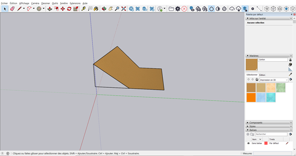

Hello, i work on material, i create material by script, then i apply this material on a component
I want to retrieve the component (face or group) on which material is applied, in script. After applying the material, the component is not selected.

My final goal is to apply materials to objects in my scene and attach a tag to these objects that will have the name of the initial material. The tag will be used to display/hide some elements of the scene.
Yes i apply the material manually with the Paint Bucket Tool.
When I say that the component is not selected at the end, i mean after painting component not in
model.Sketchup.active_model.selection
