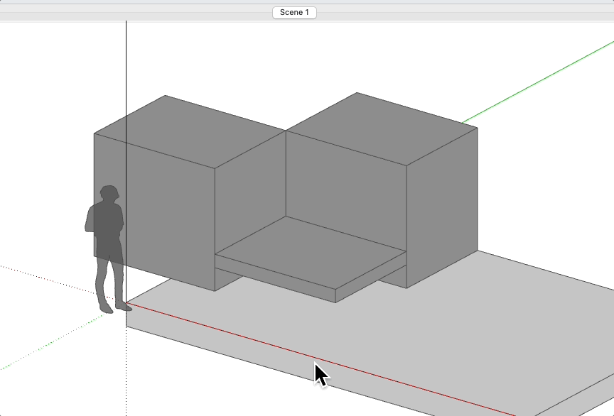

It would be wonderful if there was a simple comand on the keyboard that would allow us to push/ pull faces that is not facing you. Because even if the Xray mode it takes a unnecessary time to do it.
Thank you DaveR but I could only do it by selecting all the 4 linesā¦the time wasted selecting all the edges its the same as moving the camera underneath it. When I meant a way, I mean a easy shortcut that we all could do it less than a sec.
when I press all connected, it select another face and it wastes time having to unselect it
in the other post that I found after I posted the question
