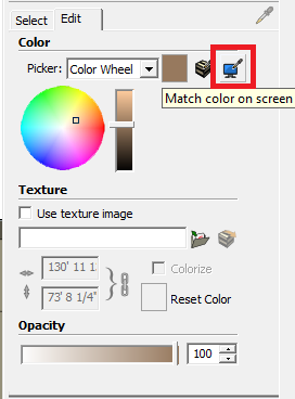

At the bottom left of your color picker window is a rectangle with the current color and next to that is a eyedropper button to sample colors from anywhere on your screen including in the model or outside of the sketchup window.
Is it on MAC?
I’m on Windows, I think I found it but it wasn’t on bottom left.
You mean this one?
Thank you.
Oops, my bad for not checking your system info, you got it right.
