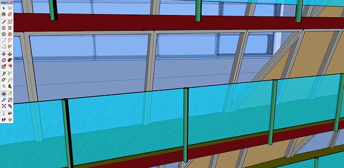

I have managed to make all the window frames with push and pull.
The Fredo seems to work on a straight facade but it still leaves me with
boxes that have an empty back (without glass)
So I resolved for the curved part to do it one by one as my whole facade is a 4sided concave curve
I found nothing that worked but working along the invisible geometry.
It was pain staking but now I am that far down and by trying to render
I realize I forgot somehow to make the glass two layers.
But the glass panes, that I can select them all at once on each of the 4 facades
when I use push and pull it just pulls, all the panes say
(20mm away from original position in our outwards)
BUT it does NOT leaving with a “tickness” that I am told I need to give the glass a good
rendering in Lumion.
In the Sketchup rendering the two glass colours are rendering
I am very concerned that I need to do each window one by one by selcting each pane and then make
a copy 200mm away.
AND I am not sure will that make the glass as a double connected volume with side planes or not
OR if that is not needed for rendering.
ALL my window frames are actually looking hollow from the inside
of each floor
