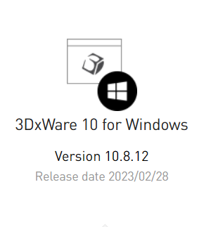

this is the driver you need
From 3dC
I believe the 3DxWare app will install 3DConnexion Home. When I upgraded SU to 2023 all I did was reinstall the latest version of 3DxWare. I think that takes care of the drivers as well.
After installing 3DxWare, try searching for 3DConnexion home on your computer. If it is installed, you’ll be able to test the SpaceMouse with the Trainer, apply Settings, etc.
Maybe I oughtn’t have mentioned the .rb file as installing should be an easy process.
3DxWare and the driver (archives) are available here:
3DxWare 10 Archives - 3Dconnexion US
