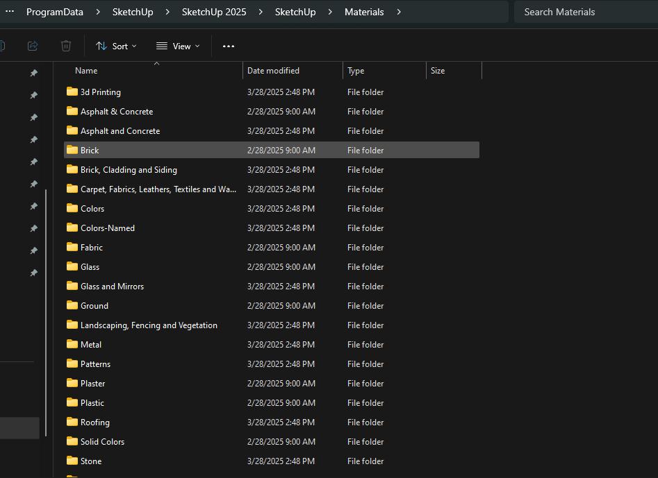

Navigate to: C:\ProgramData\SketchUp\SketchUp 2025\SketchUp\Materials
Paste into the Materials Folder:
Now when you launch SU 2025 the materials will be there.
I should note: If you want cleaner folders, open each individually and repaste so you have extra materials in one folder instead of double folders like I have. I’m too lazy to do it right now.
