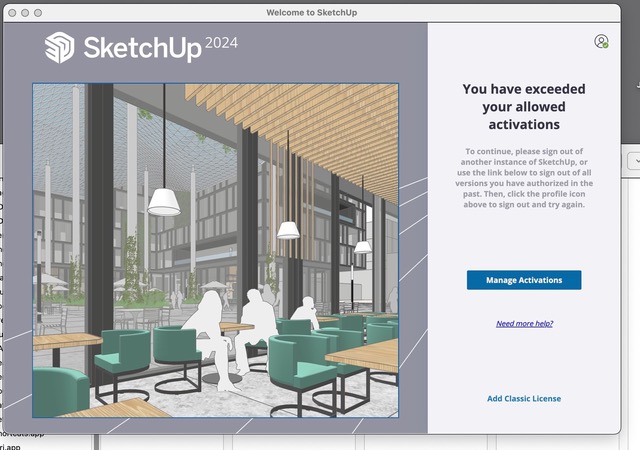

I get this message below:
I’ve signed out of 2023, by going to the personal icon and signing out. Still get the message when trying to open SU 2024.
When I go to ‘Manage Activations’, I don’t see where I can do that.
Ideas?
If you signed out from 2023, you would still need to sign out from 2024. Then when you sign in there is an available activation for 2024 to use.
