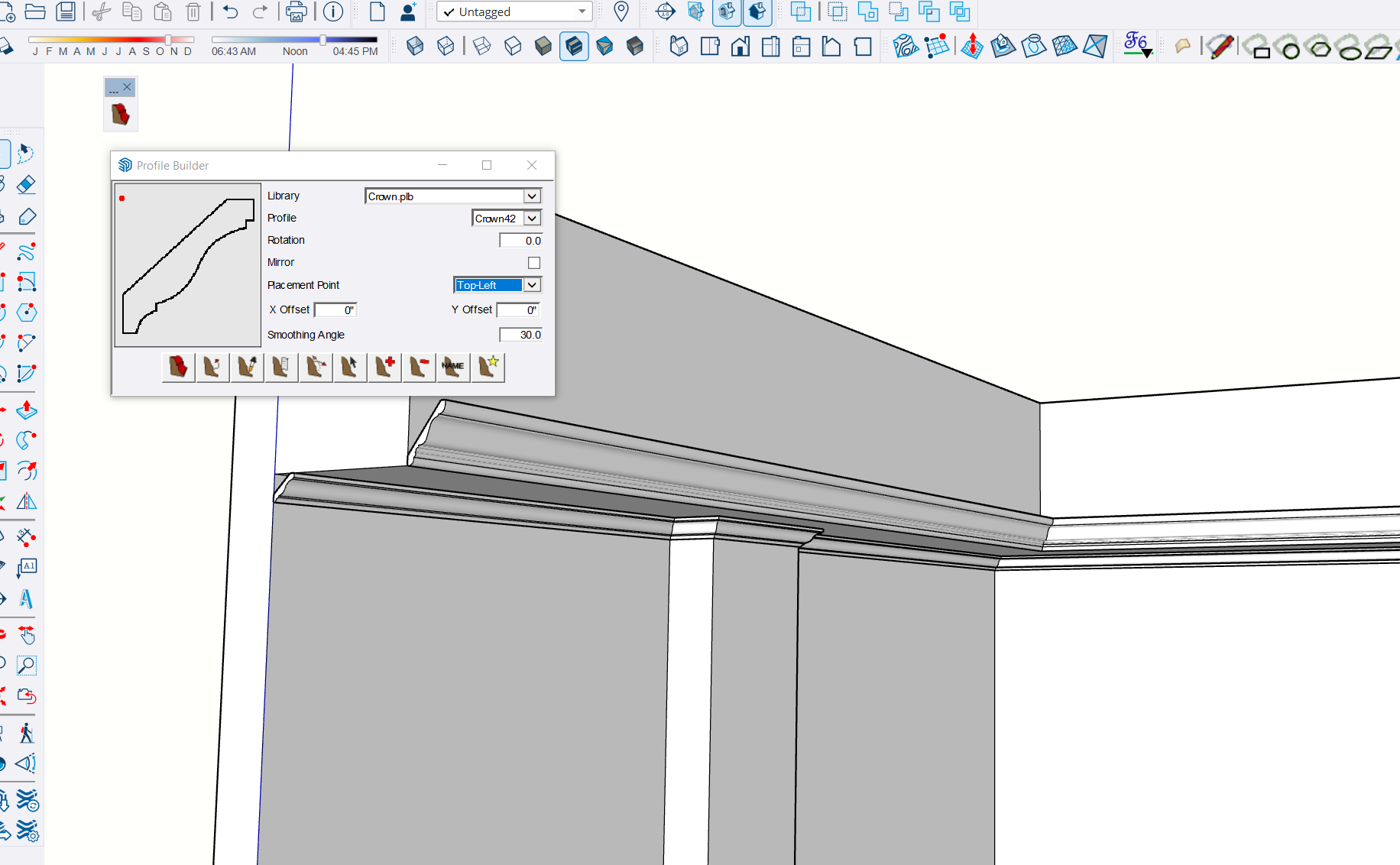

Looks to be some type of “crown” moulding used to house some type of “up-lighting”?
Not hard to do with a plugin or a profile and follow me tool.

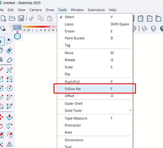

Why is it that I don’t have the follow me tool, (What is the plugin too?)
It´s called Profile Builder, the current version is the 4th, It´s imo one of the best plugins for architecture modeling, specially if you work using any BIM methodology.
