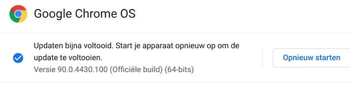

Not for me (Chrome version: almost latest (*)). Your screenshot does though, thanks.
Solved by (the importance of) updating Chrome OS!
(Thanks @Box)
Odd internet stuff.
