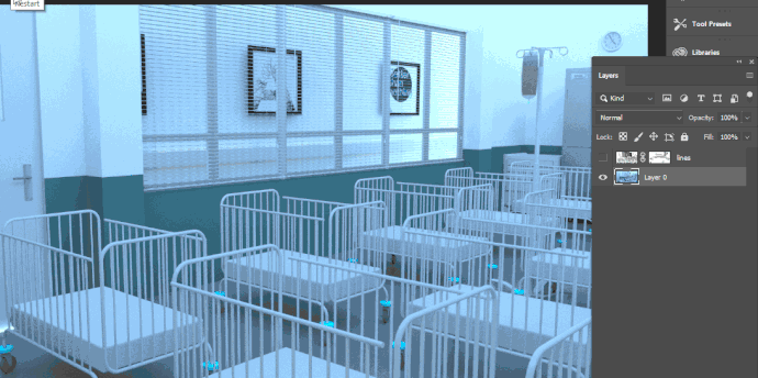

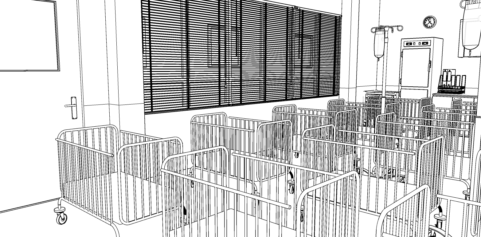

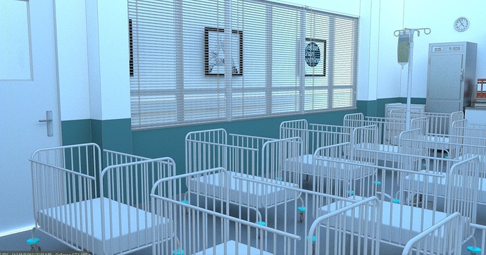

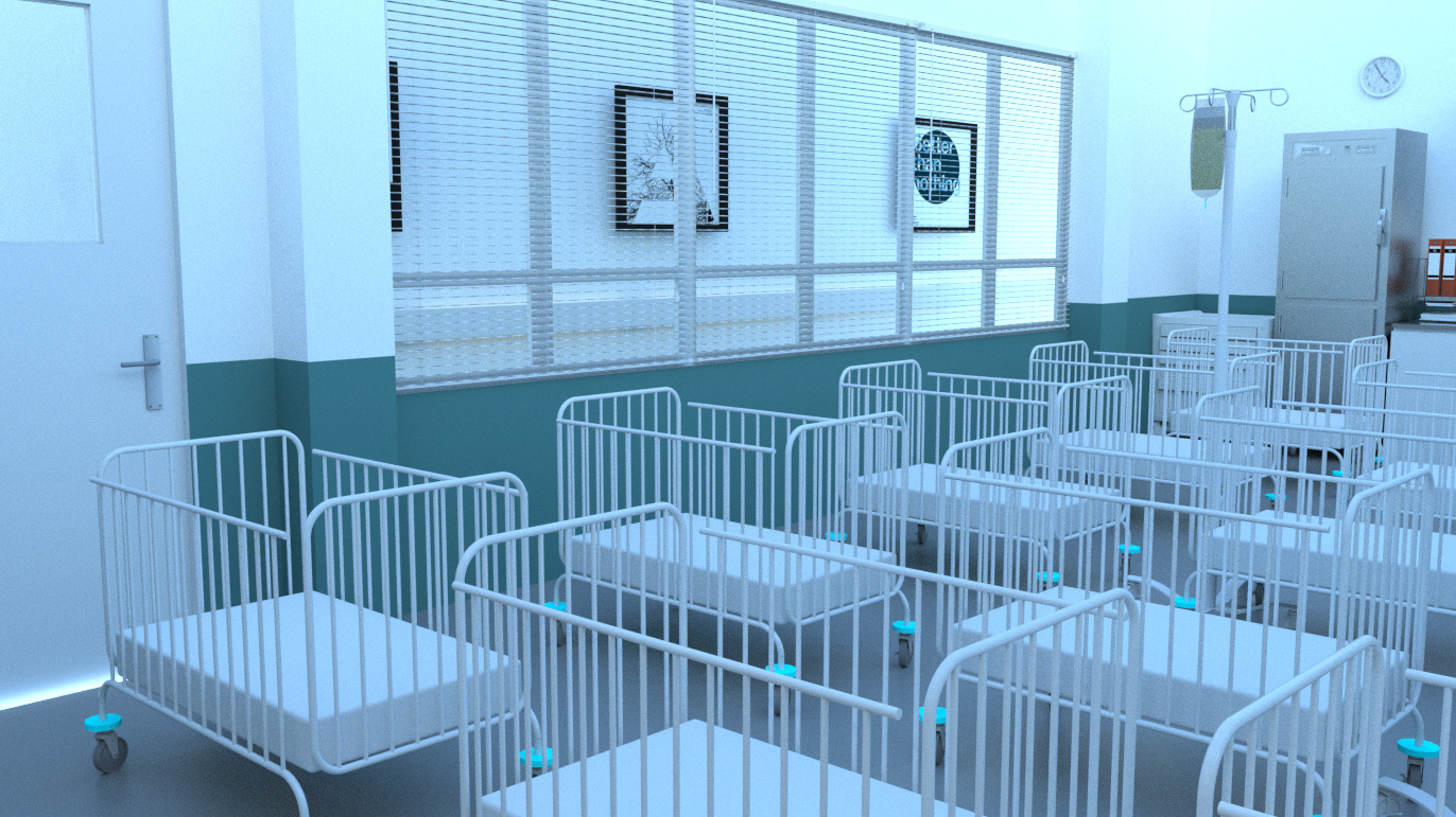

This looks to be a render with line work on top. Some render software have an outline overlay built into their looks (enscape comes to mind - Thea too but not slider control for amount), but its also possible to combine any photorender with a standard outline only image from sketchup in photoshop. The benefit of this method is that it can give you a little more control over the mix, by masking and softening of the line image. I also think that this image as a very narrow color palette which gives it a more monochrome look, again, in photoshop you can de-saturate the render to that end too.
example below
SU lines only
Thea normal
Thea withrendered with SU edges
combining lines with render in PS
