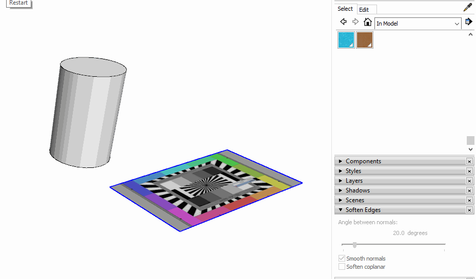

Another option … you have to specify the size of the cylinder before selecting the image to wrap around it, but from there it can be scaled and stretched as needed:

I’ve found that with cylindrical mapping, by importing image as “image” and then exploding it so it populates the materials palette, it can be sampled from there and applied to cylinder with the correct mapping.
If things go awry, then the UV mapping tool can help sort it out. While applying the UV mode the model has to be in a parallel view to keep things straight. VArious key combinations will allow it to be scaled and moved in place.
