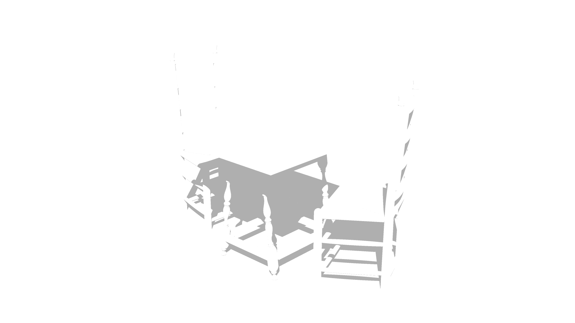

There’s no control in SketchUp for shadow opacity. You can change how light or dark they are but that’s it. When I want to do the sort of thing you are talking about, I make several image exports, one with textures and maybe edges, shadows off but Use sun for Shading turned on. Then I make another image export using Hidden Line style but with edges turned off, shadows on. Then combine the two images in an image editor. The Shadows layer in the PhotoShop would be set to Multiple and the opacity adjusted to suit.

Here’s a quickie example. This one simulates three light sources. I warmed up the shadows to give a slight tungsten hue and I applied different amounts of Unfocus Blur to the shadows. Other than cropping to get the final image, I did nothing to the base textured image.
Base image.
Three shadow images:
