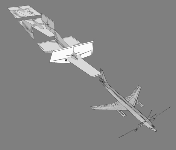

When you explode the image it gets projected into the rectangle face and you can cut off main shapes immediatelly and position them at will, effectivelly, like this:
airplane_blueprint.skp (395.2 KB)
This image is only being used as reference for drawing the model, still, it’s a reference attached to the model. It’s not going to be part of the final model necessarily. It’s a part of the process.
Of course with this process, the image itself might be part of the final model.
Anyway, I use this process for modelling from reference all the time and I thought it would be cool to share it in this post. You can’t split an imported image, but if you explode it you can split the textured face after as the image becomes a textured material on a face.
