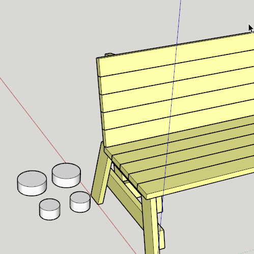

I know I am missing something here. However, I am just trying to replicate a Jay Bates SketchUp here and I can not figure out why the holes will not go through. I have the condiments hidden and I did intersect faces to get the circles.
felling stupid … please help.

Looks like your circles are raw geometry and your planks are Components. You have to have the cutting circle inside the Component for it to work.
Thanks for the help. I was brain dead ! :slight_smile:
Solid tools makes quick work of it, perhaps Bool tools if you are using make.
Solid tools Trim
