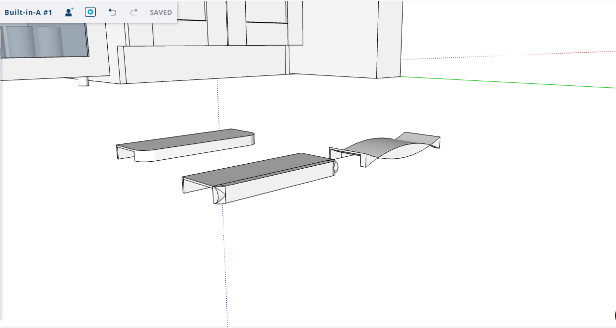

I’m trying to model a metal drawer pull that has a dual curve. Take a look at the Drawer - Pull component in the foreground. I’d like to do it with native tools (no extensions) if possible. If that’s not possible, just let me know.
I tried creating a separate “curve piece” component and then using solid tools but none of the tools gave me the final result or even something I could use. I can get the compound curve using a couple cube components (curve boxes) with the solid tools but I can’t figure out a way to use it to produce what I want. Maybe I’m taking the wrong approach. Please help.

I don’t know if this is what you want. I exploded one of the curved pieces, cut it, and pasted it in place after opening the other one up for editing. Then I combined them into one long piece. I then exploded that, cut it, opened the pull up for editing, and pasted the long curved piece in place. I erased some of the original pull from each side and used inspector to erase internal faces. That made the pull solid. I made some of the lines hidden geometry using the eraser tool / control (red tilde).
Royce,
Thanks for giving it a go but, no, that is not what I want. The front is a compound curve, the top curves down and the sides curve in.
Take a close look at the smaller model in front. Select the two boxes, do a union with solid tools. That resulting compound curve is what I need on the two front corners of the pull. Think of it this way, the top of the metal “L” is curved down to form a “pull”. Then the two front corners are rounded to eliminate the sharp corner edges.
The part is easy to fabricate out of a thin piece of aluminum or steel. I even made a couple out of red oak several years ago. Not so easy to draw.

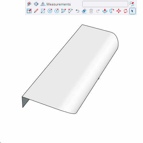

Is this what you are trying to come up with?
My guess would be something like this.

Yeah, that’s pretty cool but not quite. But, I’d like to see how you got there.
Box, hit the head on the nail, just what I was after.
Box,
No guessing needed, just like Toyota, “you got it”. The only issue I see is the hollow underside. It should be a solid piece of metal about 16 guage thick. I’ll take a look at your process tomorrow.

I unmarked your first response as the answer. It did indeed show the shape of what I’m trying to model but I don’t see the details on how you got to that shape. In my attached SketchUp file I can produce the surface with the eased over front edge and even round the two front corners (although crudely using the “subtract” solid tools) but I can’t figure out how to then use the follow me tool.
