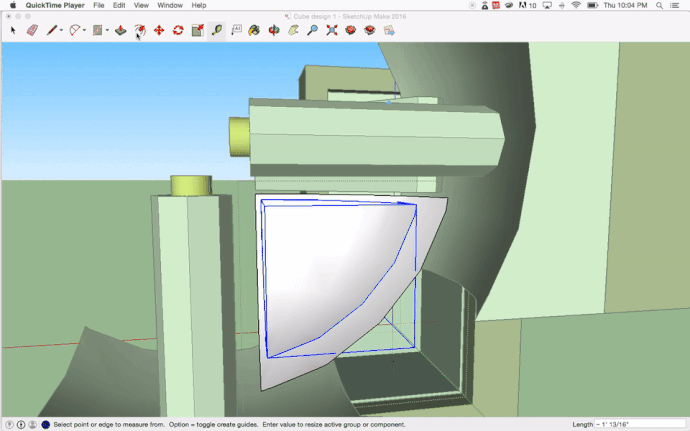

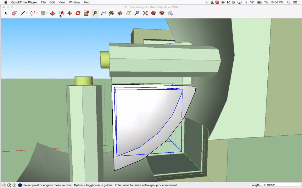

another relevant question: how can I fill in these side edges? obviously no reference sphere or anything here to intersect faces with
better yet, is there a better way to do what I’m trying to do? You can’t push/pull a curved surface, so I scaled it down by an approximated amount and have literally spent the last 2 hours doing trial and error basically by measuring each corner distance to try and get the smaller piece centered over the bigger piece at the correct displacement. Please tell me there’s a better way lol

Draw two spheres and intersect them with the corner of a cube.
And to answer your original question, stitch the end points together.

By shrinking the outer piece to make the inner piece, you compounded the problem by then needing to properly locate the inner piece as well as introducing non-planar edges at the same time. As @Box demonstrated above, if you create the outer and inner surfaces at the same time, any slicing will be done by a planar face of the cube and will result in a planar face on the three edges … no stitching needed.

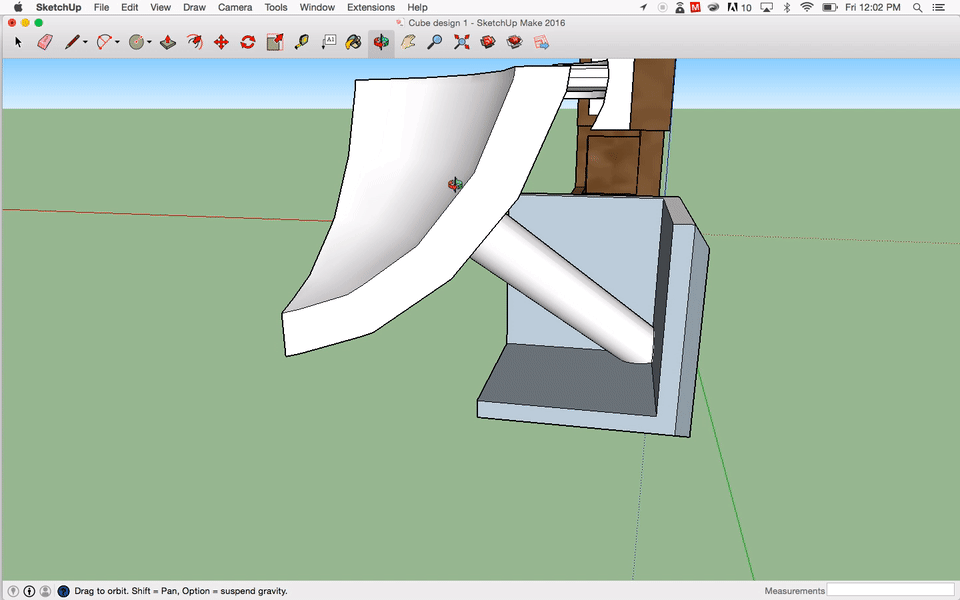

one last question (for this project!)
Cube design 1.skp (1.7 MB)
Separate the cylinder from the rest of the model (you cant do a clean job of scaling up one end with all the connected geometry.
Use Scale on one end to make it larger, then place it back into the model.
You will have to intersect it’s geometer with the sphere and cube geometry and clean it up, again.

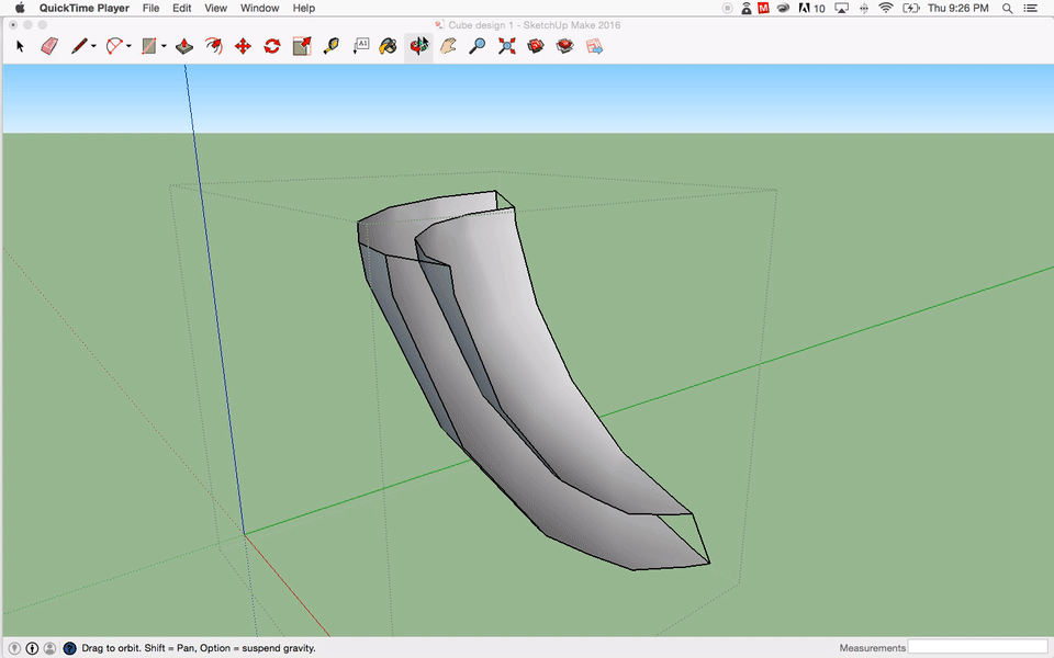

thank you! beyond that is unnecessary, but out of sheer curiosity, how would I make it more bell shaped?
While that could be done using a number of extensions, the easiest way would be to draw a cross section of the shape you want, then use Follow Me to trace it around a circle.
Select the circle, then click Follow Me, then click the surface:
