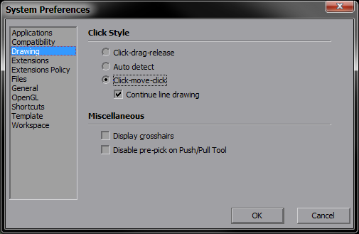

Can it be done if the user “Click Style” is changed in Preferences > Drawing …
… to “Click-move-click”:
