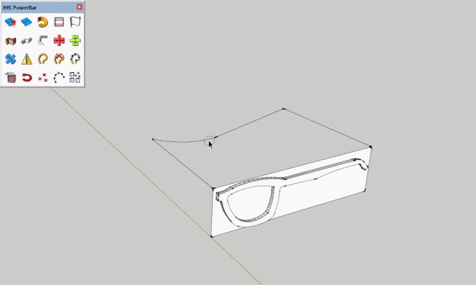

I need some help with the Flowify Plugin. I’ve watched several videos and that it was simple enough to understand but obviously I’m a noob and can’t get it right.

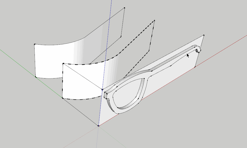

So basically I am trying to create a specific par of sunglasses and have drawn the design flat, Push Pulled to the thickness I want. Then I created the curve/shape I want it to bend to.
I put that Target face/shape in it’s own group. I then created a Base Face and put that in it’s own group. Next I created Target Lines to and from Base/Target Face, put those in a group and then Grouped all 3 together.

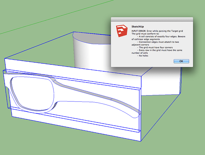

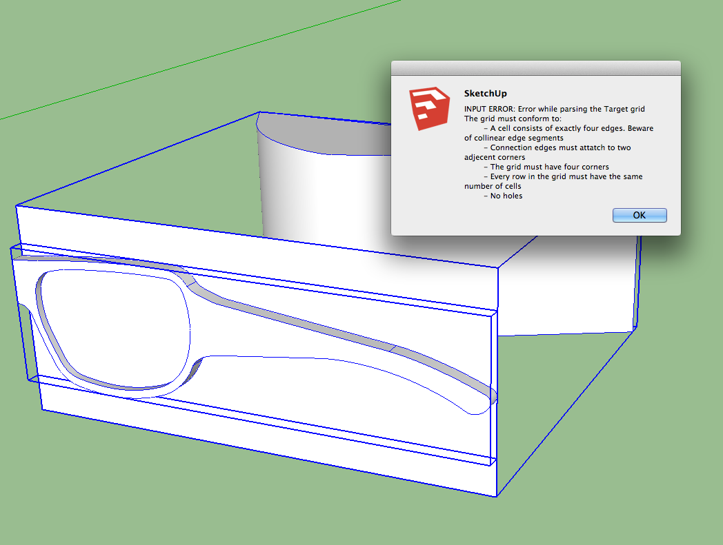

I place my half sunglass design in it’s own group. I select both groups, go to Flowify but get this multiple error message.
Can someone tell me what I’m doing wrong or if there is another way I can bend my glasses to my desired shape.
Thank You, Any help is greatly appreciated! I have attached a few images.

I see one problem is the target and base face were not created properly. I need to figure that out next.
As Cotty has already told you, target group should only contain the face, not a 3D volume. As for how you create that face, there are many possibilities, but be careful how you build it (see GIFs).
Not like this
