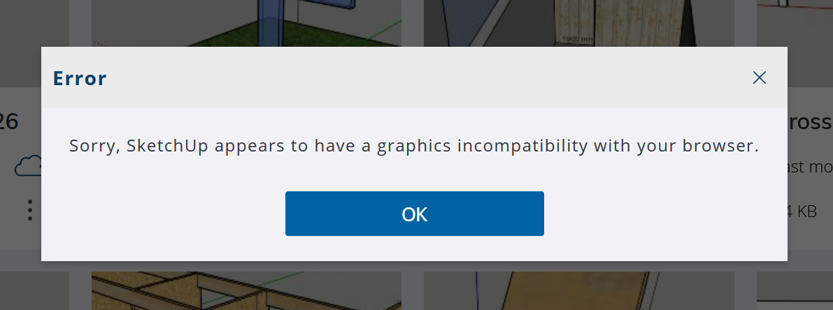

Howdy. When I try to open a new creation or try to open a saved creation I get a Graphics incompatibility message. This has never happened before and I have been using the WEB based free software for years. Any ideas..

if it doesn’t work, could you show us a screenshot of the message ?

Hi team. Thanks for all your suggestions. I have opened Sketchup in Microsoft Edge and it looks like it is going to work okay. I was using Firefox and I changed something in the settings the other day that may have upset it. I use Firefox a lot so I think I might reinstall it and see how I go.
