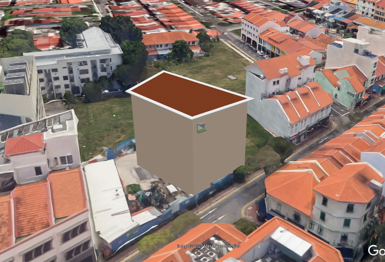

Hi all, I have been trying to open this KMZ sketchup file in my local Google Earth Pro but it keep crashing. I tried with another smaller file and it works. But this file which is 3Mb does not work. Any clue on this?

I deleted the car located far-away and the chairs inside the building. And I added thickness to the ground around the building (or wiping it completely) and to the terrace in the console.
Thanks @mihai.s for helping! But may I know what is the root cause my model is crashing in Google Earth? After reading your reply, I went back to remove the chairs and cars but my Google Earth is still crashing.
carpmael_2.kmz (2.1 MB)
I opened both models that you shared in Google Earth without any closing, but the building didn’t appear until I made the changes I wrote to you about.
Try this file:
kmz-02.kmz (2.4 MB)
I see… I finally got it to work after removing the remaining chairs. Thanks for that! Appreciate much. ![]()
