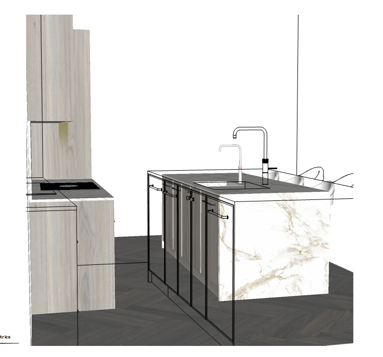

Hi All,
I experienced such an issue on number of occasions and always spent too much time to got it sorted.
Any ideas why additional contours appeared in front of the actual isometric view?
Appreciated any thoughts.
Thanks
Rob
Hi All,
Thanks
Rob
That’s a typical graphics issue when the model, or some part of it, is placed at a great distance from the origin in the model space. The fix is to move the model closer to the origin.
Thank you David!!!
I can’t believe such a simple thing sorted my issue.
Many thanks!
