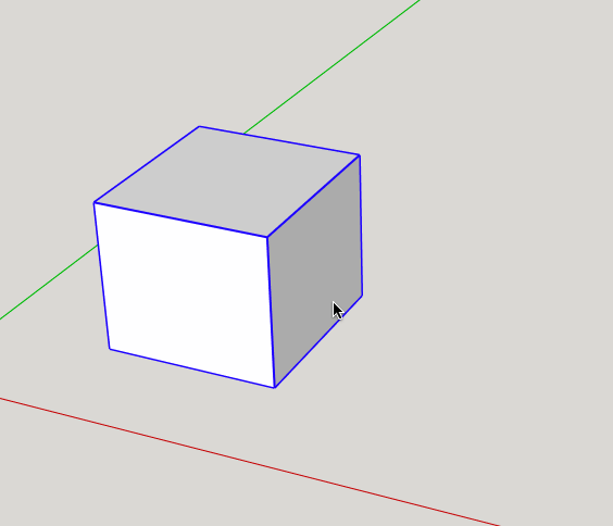

There is something weird that happens! If you generated inferences from vertices on an object and then make that object’s tag non-visible, those inferences are remembered by the engine but vertices that were not previously inferenced are not found. In the attached, the box is a component. I first activate the line tool and float it over two vertices to get inferences at them. Then I make the tag of the box non-visible and try again. As you can see, I can still get the previous inferences, but I can’t get new ones to any other vertices of the non-visible box. I find the inconsistency to be quite confusing.

It’s only the few that you pointed at with the ‘Line’ tool. Clear them from memory by pointing at several now visible new inference points.
You are right that it is somewhat inconsistent. Memory should be cleared from invisible inferences when disabling tags.
