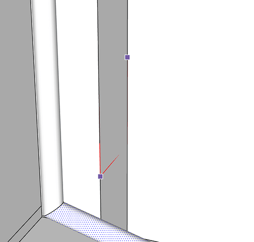

This seems to be an ongoing problem that sometimes occurs when new versions are released. But this time, the amount of image clipping when zooming in, is ridiculous. I constantly have to change the camera from perspective view to parallel projection to be able to zoom into a model. This effect very rarely occurred in SU2019
(MacBook Pro late 2018, 2,2Ghz 16GB RAM, SU2020.0.362.
Can this please be fixed…

I think I seem to have figured out the problem. When checking the model before sharingTyberberg Hospital Roof Details Rev 7 SU2020.skp (12.2 MB) , I clicked the ‘Fix Problems’ button and ‘Purge Unused’ and voila … things seem too be a lot better, in fact, problem solved.

The most common reason for these display artifacts is that your model is very far from the model origin point or that the model itself is very large, containing, for instance, an imported CAD map.
Or you have been working in parallel projection and the camera has wandered far from the model.

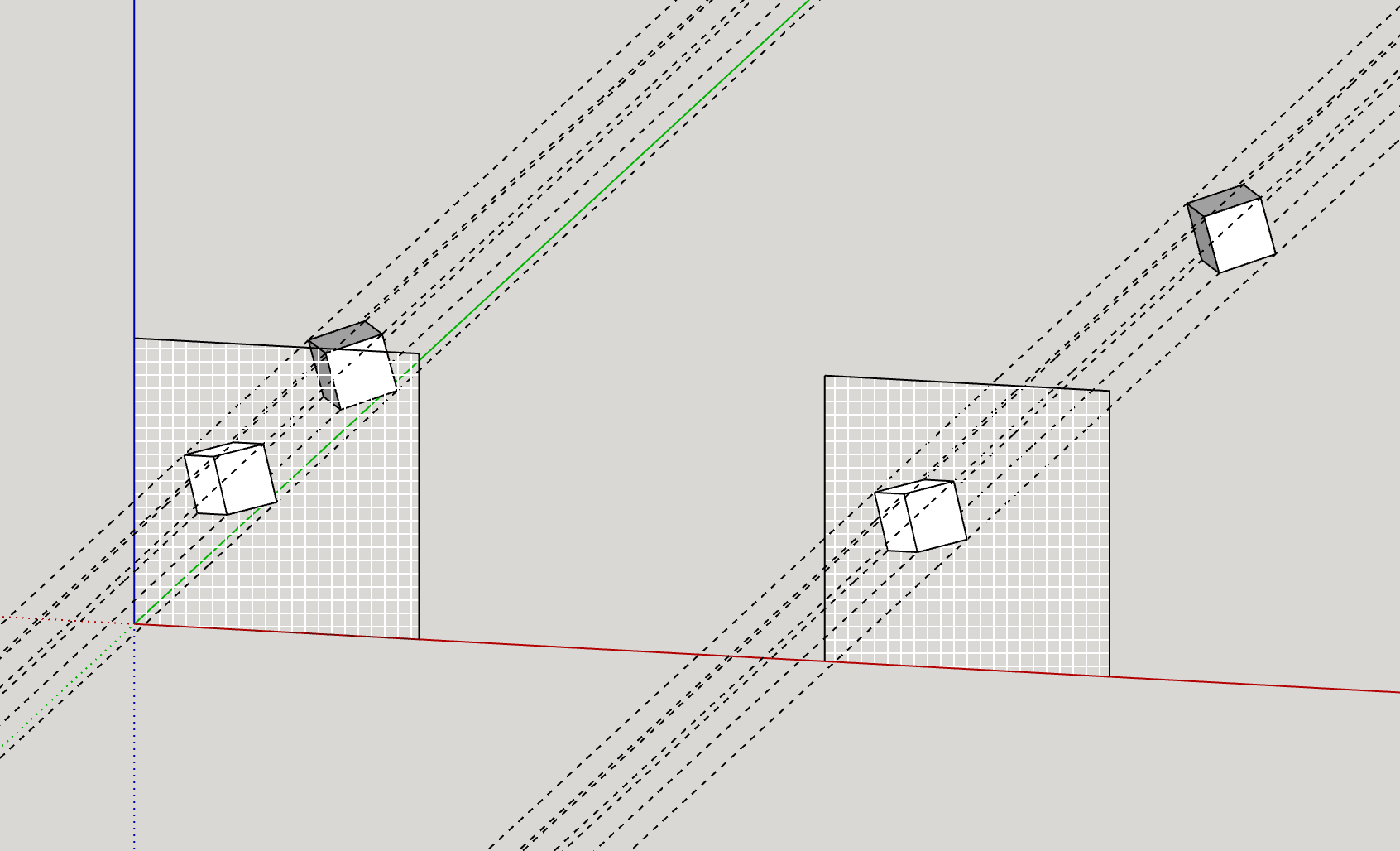

Here’s an illustration of why parallel projection can mask the fact that the camera is far from the model. In this model I created a vertical red-blue plane rectangle to represent the view screen of the camera. Then I drew a cube at a skewed angle behind the screen along the green axis (in front of the camera). I created a guide line parallel to the green axis from each visible corner of the cube through the screen. Finally I traced the intersections of these guides with the rectangle to create the screen view that parallel projection would make.
Then I copied the setup and moved the cube farther away along the green axis. You can easily see that the presentation on the screen is identical. There is no perceptible effect from moving the camera farther away from the model or vice versa!
parallel projection.skp (38.6 KB)
Hi, thank you for your comment. Yes, the original model had an imported area map, which I have now deleted, in fact I cut and pasted my model into a new blank drawing, but still persists.
Thanks for the reply. Yes I have been using parallel, but do so reluctantly because of the clipping. It seems the problem is just getting worse. Seems I have to restart my model from scratch, even reluctant to do a cut and paste from the original…
I’d recommend you practice using perspective until it becomes natural. Issues with clipping and camera positioning are much more common when using parallel. Plus, zoom extents will usually restore a sensible camera location in perspective mode whereas it may make things worse in parallel!

I think I may have come up with a solution. In this particular model, I had imported a fairly large area dwg which seems to have caused the problem in the first place. I think either Box or monospaced mentioned something about this. I removed the offending map, and viola! things seem to be back on track.
