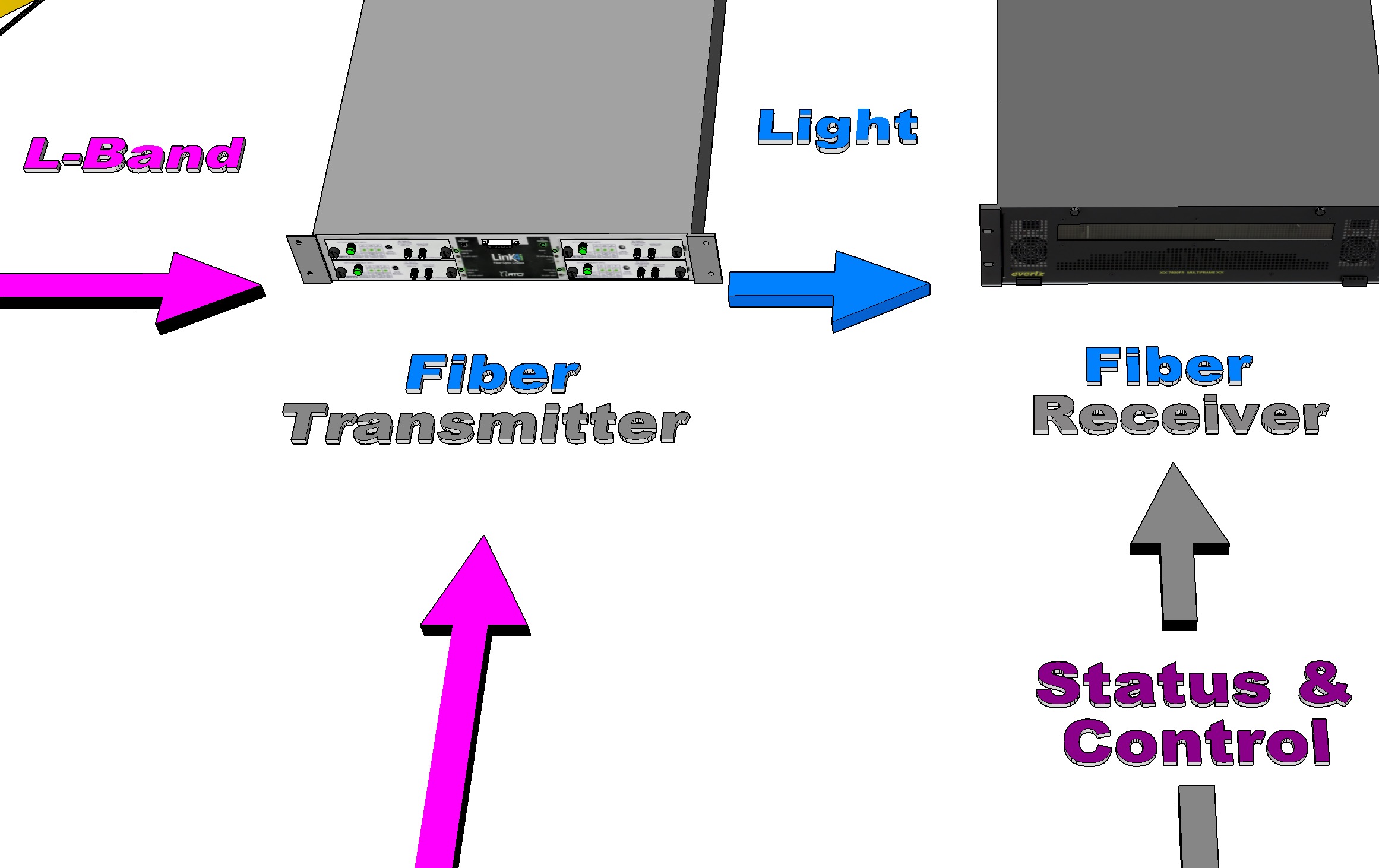

I can’t upload the entire file, but this is doing the same thing. Just a part of the file. WHen I hit the “scene” it adds outlines and edges with profiles. I deselect, update scene, but then when I click on the scene, it automatically puts them back
Yep all of those are checked. I am creating the initial scene without the edges and profile being checked, but it is automatically adding those each time I hit the scene.
