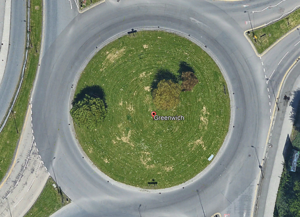

As an illustration consider the Greenwich coordinates 51.4934° N, 0.0098° E. The first picture is from Google Earth, the coordinates in the roundabout center.

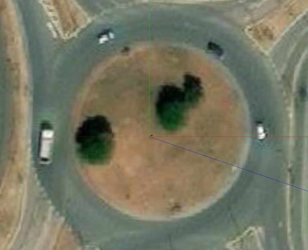

The second picture is by importing Digital Globe imagery into Sketchup, clearly the coordinates does not pinpoint the center.

I get the same results as you do … I wonder if this might be related to the underlying 4-meter resolution of the GPS system. Or not. Just a thought …
I find it hard to believe that the rather lousy precision of the Digital Globe imagery has anything to do with GPS limitations. If so, why do Google get it right?
The GPS “selective availability feature” was lifted in year 2000. Modern L5-band GPS receivers these days pinpoints to within 30 cm. And then you have other competitor GNSS vendors like GALILEO and others…
This is - in my opinion - a matter of postprocessing to locate the imagery to reference points. And by using other readily available sources (say from DGPS) the imagery should be pinpointed to 3-5 cm (at least). In these days with professional GNSS equipment delivering way beyond what Digital Globe gives, I find it hard to imagine why anyone would use Digital Globe at all… at least for anything beyond pure illustrative purposes.
I am really curious why I observe what I have illustrated above…
