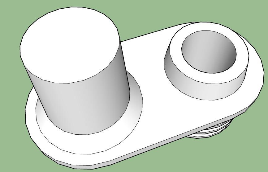

i am not able to find the volume of the model (attached file). under entity info it is not detecting as solid group. i have tried my best to remove all the internal edges & faces.
need help!

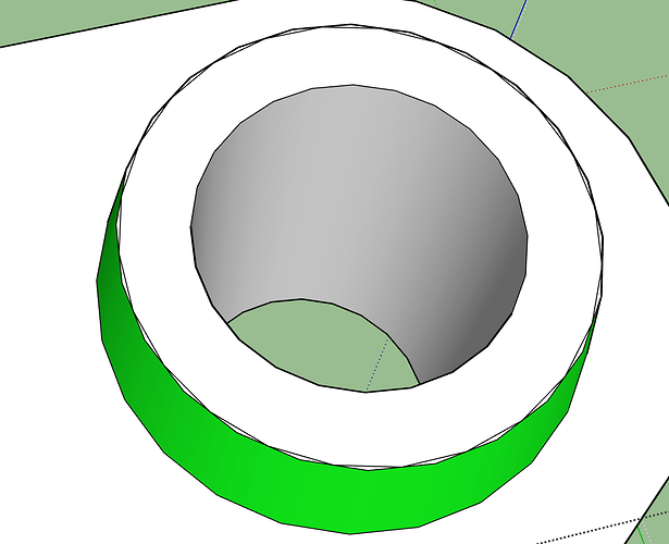

There are several things wrong with the model, to prevent it from being a solid group:
1)The group contains a nested group
2) if that is exploded you still need to give that tube part thickness
3) no back faces (grey) on the outside.
4) the top contains ubnecessary circles on both sides
Thank you @Wo3Dan & @slbaumgartner for the help. I was going crazy cause the volume won’t show up, thanks to u guys my problem solved
