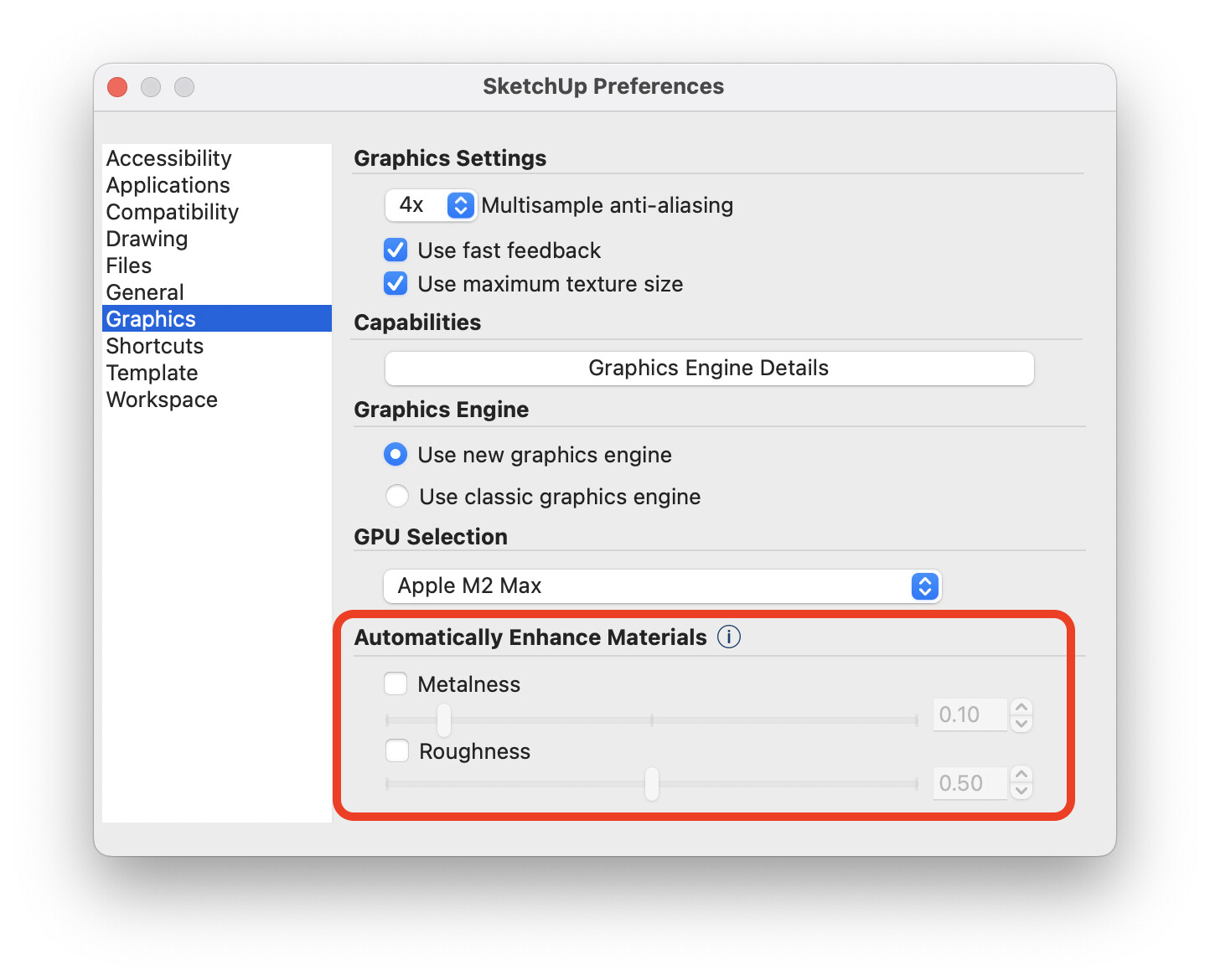

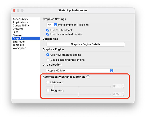

In 2025 go to preferences and turn this off.
Then go into 2024 and save a template with all your usual materials…
Open in 2025 and Save as Template…
All older files you open will come in with the old swatches once you do this (unless you switch folders within the materials chooser).

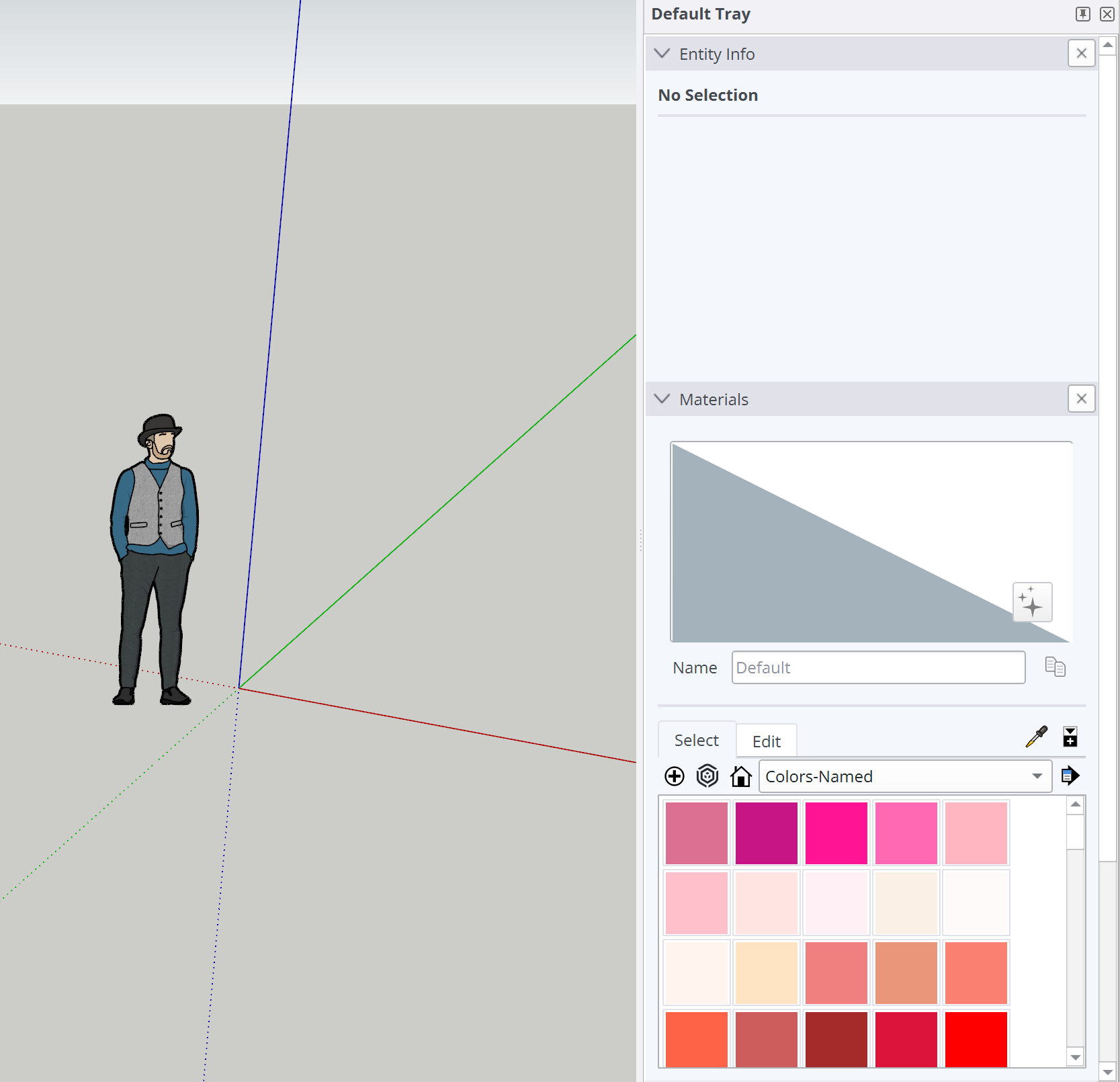

If you read my posts above you can make sure the new icons don’t affect your work. And it won’t affect your modeling. I just started a new project from scratch with my template and never once saw a cube in the materials picker.
Funny but true—I was doing the exact same thing. I couldn’t tell what half those materials were either. The only way to figure it out was to read the name, which kind of defeats the purpose of having thumbnails in the first place!
Anyway, I ended up restoring my setup. All I had to do was delete the 2025 materials folder and drop the 2024 one back in. Back to normal now—and way more usable.
