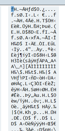

Min Plenitude .skp (6.6 MB)
That’s not a SketchUp model file. It doesn’t even have the SketchUp header information at the beginning of the file. There’s no way to recover anything from your file. In a hex editor your file looks like this:

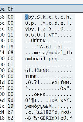

A viable SketchUp model made in SketchUP 2025 looks like this:
