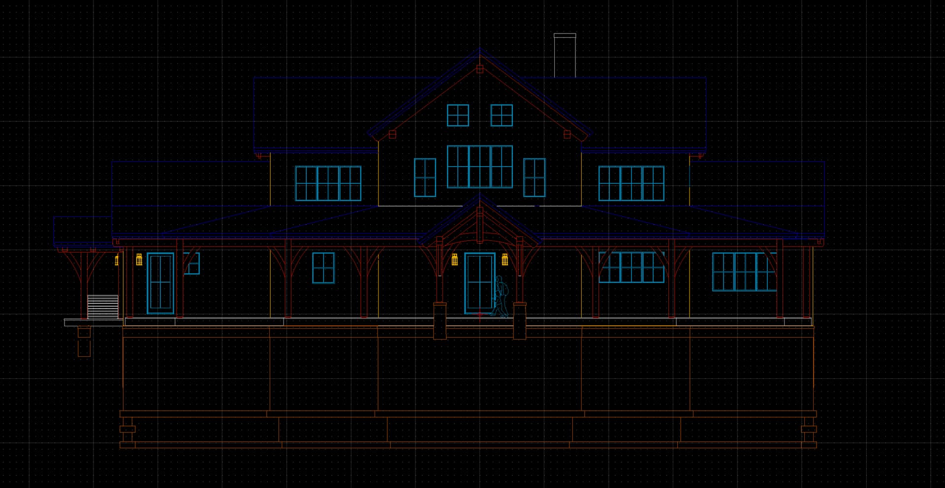

80% of the model…Like 50% of the time. Same problem on Mac also. On Mac the drawings sometimes get corrupted too and I have to open each xrefed DWG and save them. Been happening for 2 years now….Seems to just start happening after I have exported several times. Then I need to close Sketchup and re-export….Really is horrible but I am working thru it hoping this will be fixed soon. Every single model does it. Simple, complex it does not matter.

You surely are aware that 2D DWG export from SketchUp only exports what is visible on your screen so if you are zoomed in to a detail and export, the rest of the model is left out.
DWGs. I xref them in AutoCAD. Yes I have around 30 projects with around 15 DWGs exports from Sketchup into each. Floor plans, elevations, roof, sections….. I know what is suppose to do and it was fine until 2 years ago going on 3. If it was a permissions problem it would not allow me to open the files and save them. Autocad for PC does not allow images to be exported while they are loaded in the program. I unload them and then I can export images. Images do not have any issues. Only DWGs.
