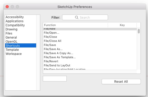

I wanna export my shortcuts file of my Sketchup Pro 2018 from a PC to the same Sketchup but in Mac, my I mac just have not the option to import it as the PC.
This is a screenshot from Imac preferences in the shortcut’s tab.

The way SketchUp saves the shortcut settings is changed with version 2018. They are now in a .json file located in your Appdata folder (C:\Users\ USERNAME\AppData\Roaming\SketchUp\SketchUp 2018\SketchUp\SharedPreferences.json)
I have not tried, but you could try to replace the whole file to your Mac and put it in your user application support folder (~/Library/Application Support/SketchUp/SketchUp 2018
@MikeWayzovski is basically correct. SketchUp for Mac has never had the export and import buttons because the shortcuts have always been stored in a user-accessible plain-text plist file on the Mac, unlike in Windows where they historically were only in the Registry.
As of 2018 the shortcuts are now kept in that json file on both Windows and Mac. However, the contents of the file are separated into “Windows Only” and “Mac Only” sections, and each OS will ignore the items in the section for the other one. If you take the json file from a Windows computer, the “Mac Only” section will be empty. Alas, the keyboard shortcuts are in the section for the source computer and I think they won’t affect anything if you simply copy the file across. I don’t have ready access to a Windows SketchUp right now to check whether it would work to just copy-paste the shortcuts list from the Windows Only to the Mac Only section or if there is a difference in the coding.
