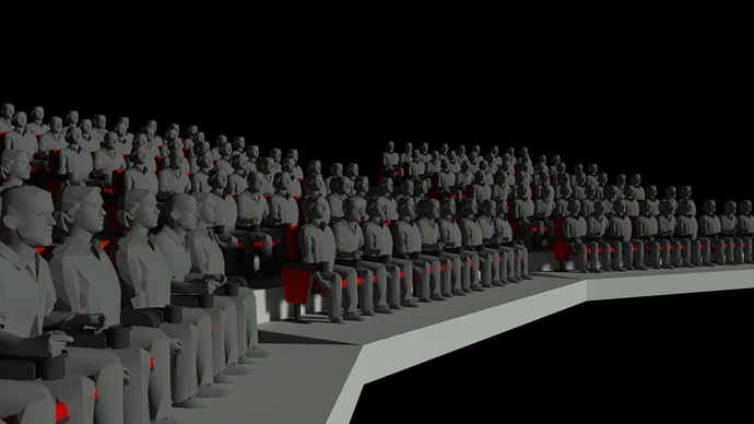

here is a quick mock up - very crude (i hadn’t seen your space) but just to illustrate the concept. This was just using 3 different formfont people. The people could be “smoothed”
I don’t subscribe any more, but I have accumulated a small library of downloaded figures that I use occasionally, but I am now using axyz 3d people for work as they are realistic - but high poly.
You can use non-seated people too…in the example only one was seated and I just copied the legs over. The others were standing people who I chopped the lower half off.
in the 3d wharehouse - if you search for 3d people sitting there are a few that i think would be great…you can find some variation in standing people and modify I I did above?
Hope you are able to achieve what you need. One last thought, it may prove useful to make 6 of your chairs as unique components before you distribute them in the space, that way you can edit each one and assign a figure to it which will populate the other same component chairs, not only will it be a more efficient way to add the people, you can also change the people as needed which can vary the audience in different setups.
