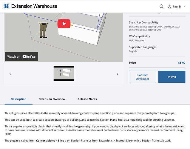

But I get the message “Eneroth Slicer isn’t licensed. Do you want to open the Extension Warehouse to get a license?” If I press Yes I get the attached screen with no Buy option?

You have previously bought Eneroth Slicer. If you choose Install, does it get installed?
