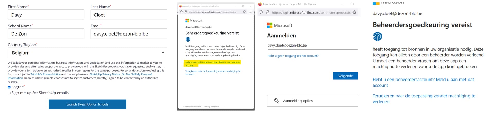

Hi @CaseyG ,
thank you for following up on this case.
I attached pictures of the steps I am taking.
I’m registering myself in step 1.
Step 2 requires the administrator of our Office 365 environment to grant access. That’s me, so in step 3 I re-enter my name and password.
After which I return to the window from step 2 again.
So I end up in a loop.
Is this clear to you that way?
Thanks for the screenshots @cl_dav! I’ll ping a few people on the SketchUp for Schools team and see if I can find a solution for you.
Generally, errors like this can be caused by a number of things ranging from an overzealous popup blocker, or a bad file in the cache or an invalid cookie, but I am not 100% sure what the issue is yet. Hopefully we can get you up and running soon!
