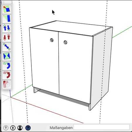

To change the measurements of an existing Corpus, I tried the extension FredoScale.
Example with the task of increasing the widthness:
You have to move the middle plane twice before you increase the widthness.
Is there any way (with any extension) to scale such a corpus with doors more easily?
Generating a corpus is a frequently used standard task, therefore I’m looking for a fast method.
The paradigma is always the same: Changing measurements but keep the thickness of the plane material.
How do you solve such tasks please? Thanks.

Here it comes as an upload:
FredoScale2
The GIF is created by Jörg Jäckle.

As you can see in the GIF, I used the same Fredo Tool as you did.
