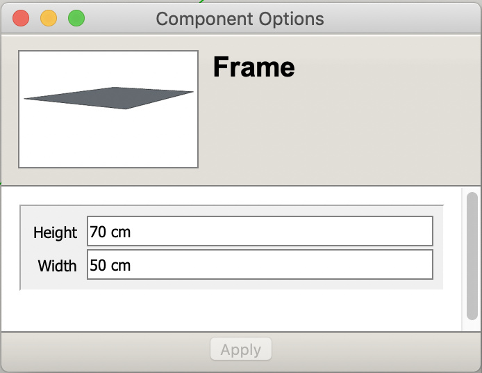

Inside your parent Frame component you have a nested component FrameSize.
You need to give it attributes, and set them to the values the user entered.
Like this:
Then it works.
These are the Component Options for the Frame (parent) component, which you have set to display using the Attributes dialogue.
Hi John, this has fixed this issue, in the video it is slightly different but going over the steps just now it has worked, and unlike earlier today i am not getting random decimal values, but nice CM measurements :slight_smile:
