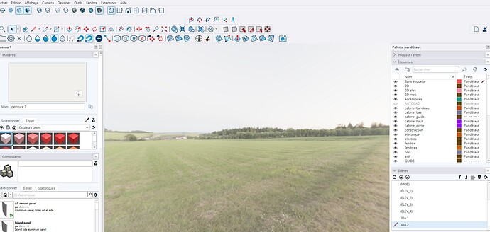

When I opened your file this is what I see.
Are you expecting something else?
I’ll go through it and do my standard cleanup procedure to see if I can make it more responsive.
Ok….. on my side I dont see the drawing at all…. could it be related with the updates

Have you tried using Zoom Extents?

I tried the zoom extend with no luck and I think the update where on scan essentiels and Revit ( I don,t even know why I have a revit extension)
