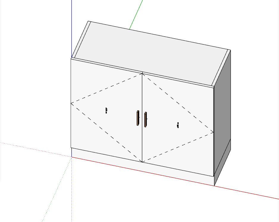

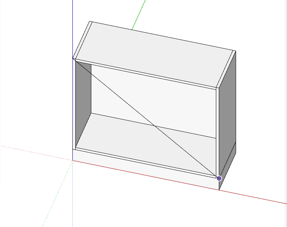

screenshot for the plugin
step 1 : click button
step 2 : draw two points
step 3 : it will be replace a DC
