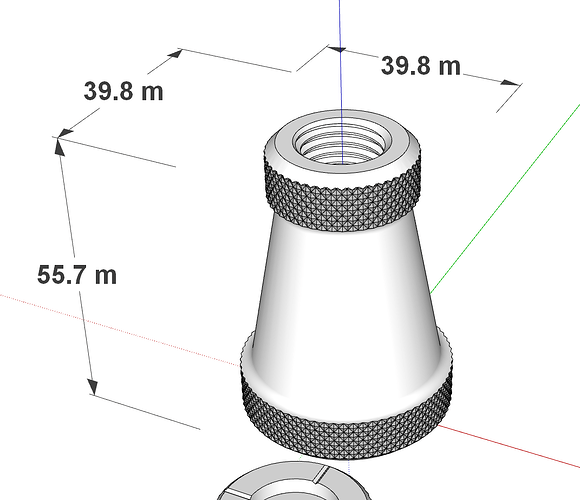

You misunderstand. SketchUp is NOT unitless. Stereo Lithography (.stl) files are unitless. You can model in SketchUp as if meters are millimeters and export the .stl with Model Units then open the .stl file in the slicer. There will be no need to do any scaling in the slicer.
Example:
Model in SketchUp
.stl file opened in slicer.

Or just forget about inches if OP wants his print to be in MM. They just type as if they are in MM but SKP is set in meters, so it’s 1000 times larger. Export the model and the slicer won’t care. This is how I modeled some stuff I needed for my touring bicycle. Looked funny with the little man there in SKP but fit in my hand after the print.

I mean, maybe. But just set your Units in SKP to meters. When you model of you think ‘oh, this line needs to be 8.25mm long’ you just type 8.25 because, METRIC!
