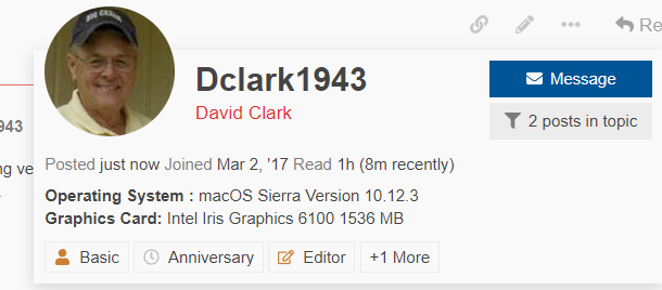

I am using version 17.1.173 & added a photo to my profile, I tried to add alternate email, and it wouldn’t accept it.
The photo is nice but the SketchUp version isn’t there. Evidently the OS version is incorrect, too.

Ok, let me try again: Sketchup version: And Mac version:
and monitor: ASUS
I hope
this will provide all the data points needed for any advice you can provide me

I am using Version 17.1.173 & I added my photo
