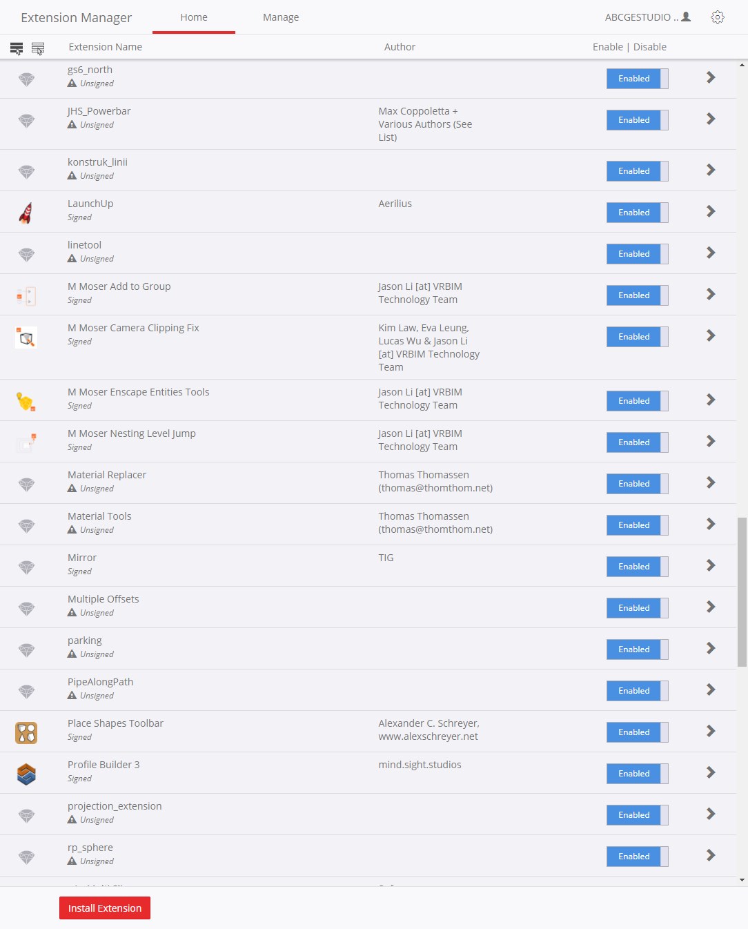

Tucker, I’ve already made the screenshots with Extension Manager, so it goes in
alphabetical order.
I use quite a lot Fredo’s plugins, I recently bought various Curic ones but to tell the truth I’m just too busy to really try them, they are just there, so I don’t know if they causes problems or no. As I said before I’ve never experienced the grey-out commands…
